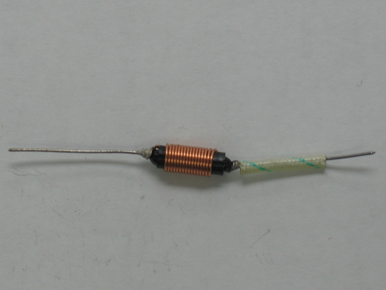

Hello Claude, in this 4th post you mentioned something, you wrote: "I guess it worked from the start because the power coils L503 L504 got hot at one point".. On the cobra 25 the one coil still looks shiny copper.. So Question: these two power coils, on my super Star, do they need replacing, or are they ok to continue to use?

There is nothing wrong with those which changed colour.
You could replace them, but new ones will change colour the same way unless you replace them with higher current rating.

Redbandit wrote: 24 Sep 2020, 15:48 but is replacing for higher current ones an ok thing?
These are just RF chokes on the power line and there's no reason to change them (unless they're open circuit) , even if they are slightly discoloured .

Thank you Sammy, good to know. I am aware of the gap in the pot which the straw can be inserted. As for the RF choke, I guess I will leave them as is.
